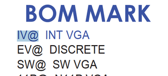

Ahmad Safari Registered Golden Reputation: Jan 10, 2022 #6 Remove and test. If it does not work, you should put the parts with the iv @ symbol in the schematic on the board. Attachments Untitled.png 22.8 KB · Views: 10
