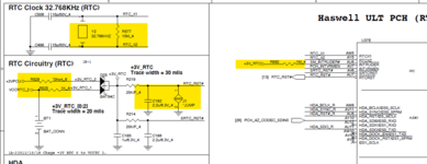

SVOD shows ITE busy with all pins ok and new chip, there is something goin on up that side of the board.
I believe the Super IO is connecting to rails that are creating a short?
laup
the pch could be weak link here? customer says it took more and more attempts to turn on, ive lightly bottom reflowed to no avail
