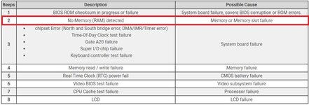

13269-1. i am getting 2 beeps. All voltages are normal. The final signal (plt rst) - 3.3v. Cpu is also heating fine.
2 beeps and no display. Any idea ?
Tara Laptops
Tara laptops
all ram voltages are normal. From ram slot all signals directly goes to cpu. i even replaced the cpu still 2 beeps
