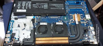

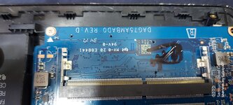

Mother board m no. DAG75AMBAD0 REV : D
Model. 15cb088tx
My laptop problem is capslock blinking no display.
I try to flash many bios bin files but still the same no display capslock blinking.
How to fix it ?

how many time capslock blinking ?? count the blink and replay result .
So which componenet is failure can you located me plaese
at first you must check always voltages .
this model have boardview file . so you can use it .
check all after boot voltage like cpu voltage , gpu voltage , ram voltage , ....
anyway , i solve this problem with replace pch with new one in many case . but you must check everything at first .
