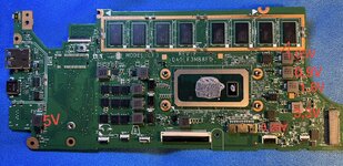

i have this voltages on board, no low resistance on coil, bios is alimented, i've try to reprogram but no result

You have the voltage of the olwayse , but you do not have the voltage of the next stage.
This problem can be from the BIOS and EC. Also the path of communication signals between EC and PCH.
