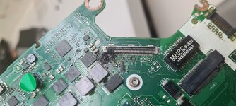

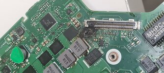

Motherboard MODEL DH5VF LA-F952P
1 where to find the schema and the boardview?
2 on the photo attachment where this connector and the model are found, thank you
3. there is water flowing over the connector, how do you know which components need to be replaced?
thank you for your answer
You have a connection in the b+ path and you can easily solve the problem.
Clean the motherboard and send me a picture of the board.
remove the connector. After removing the check resistance of connector pin, test the pins it has connected. (b+)This voltage enters the motherboard from the battery or charger and enters the corresponding jack after passing through the inductor.
