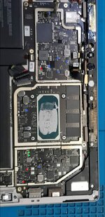

on this photo the surface is off.
on red dots: static 15V
on blue dots: 6V
on green dots: voltage changes from 18V goes down to 6V

on this photo the surface turns on
on red dots: 3.3V
on blue dots: 0V
on green dots: 6.1V
on white dot: 5.1V
after 5 seconds surface turns off and voltages go to 0V

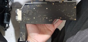

Valentin
I don't see anything else here. Do you?
