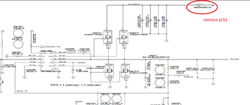

Hello, I have a notebook with video problem. It's possible convert to UMA?
U user61648 Angelo Registered Golden reputation_scoree Apr 28, 2022 #1 Hello, I have a notebook with video problem. It's possible convert to UMA?
Ahmad Safari Registered Golden Reputation: Apr 28, 2022 #2 remove pl31 First take the inductor and test it. If it does not work, you should put all the uma parts in the schematic and delete the parts written with dis. Attachments Untitled.png 115 KB · Views: 5
