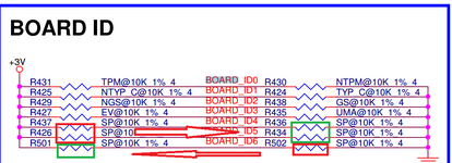

How to disable onboard ram ?
Ahmad Safari Registered Golden Reputation: Apr 4, 2022 #2 R437=>R436 R426=>R434 R502=>R501 MOVE AND TEST. Attachments Untitled.png 97.4 KB · Views: 20
Tara Laptops Tara laptops Registered reputation_scoree Apr 5, 2022 #3 Thanks brother. I will try and inform you
Tara Laptops Tara laptops Registered reputation_scoree Apr 6, 2022 #4 i dont have the board view. Pls provide.
Tara Laptops Tara laptops Registered reputation_scoree Apr 6, 2022 #5 Ahmad pls provide me the boardview. Without boardview i dont know the resistor location
Tara Laptops Tara laptops Registered reputation_scoree Apr 8, 2022 #6 pls help me with the boardview. I am still waiting
Ahmad Safari Registered Golden Reputation: Apr 9, 2022 #7 Tara Laptops said: help me with the boardview. I am still waiting Click to expand... Not available
user60332 MEHMET Registered Golden reputation_scoree May 22, 2023 #8 Ahmad Safari said: Müsait değil Click to expand... Merhaba; bu bahsettiginiz dirençlerin yerlerini kart üzerinde işaretleye bilirmisiniz. boardview olmadıgı için bulamıyorum teşekkür ederim. Attachments 20230522_130905.jpg 8.5 MB · Views: 1 20230522_130958.jpg 9.2 MB · Views: 1
Ahmad Safari Registered Golden Reputation: May 23, 2023 #9 user60332 said: Merhaba; bu bahsettiginiz dirençlerin yerlerini kart üzerinde işaretleye bilirmisiniz. boardview olmadıgı için bulamıyorum teşekkür ederim. Click to expand... Merhaba Sadece şemaya ulaşabildim ve şemadan çalışma yöntemini anlattım ve önümde anakart veya anakart yok.
