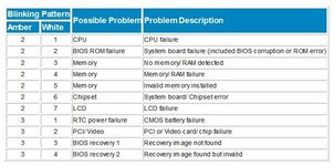

Hi, I have XPS the fan turns on and the CPU gets worm and it gives 3 white and 2 amber blinking, looks like a video chip failed. any thing I can do to make sure or fix?
Mamdouh
LA-F541P 2018-3-28 rev. 2.0 (A01)
When i tested different memory i gave 4-2 and later white on for 4 sec then fades.
