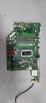

The heated part is PU401 RT6575DGQW 3V + 5V power integrated circuit, if it is heated, there is a problem in the output part, you can check for a short circuit,
