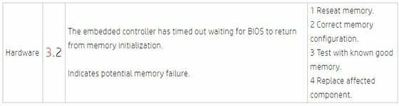

It was turning on, but no screen just blinks caps lock 3Long 2short.
What i've tried:
-changed ram in 2slot,
-cleaned memory socket,
-I measured ram coil:1.2V,
-Programmed new bios dump from list,
if anyone has any other suggestions, please let me know.

if you change and test ram and ram slot so you must have problem in bios or bios file .
do you program ite ??
you must program bios and ec with same version files .

no, i didn't program ite. I dont found ec dump. I just dowload bios dump from HP list and program. 😬
