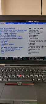

I have 60 of these lenovo p50 laptops I need to get into. is it possible to get a bios to load into the chip that will work for all of them. they are identical.

send motherboard model
mort2259
Sorry never done this before
Nm-A451
Rev:1.0
Yes
mort2259
loaded and verified. three green blinks when i hit the power button and it does not boot with the file you gave me
