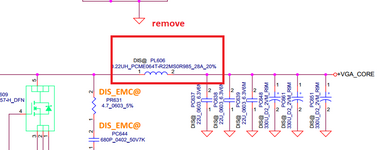

Apply the changes according to the attachment.
Remove the graphics power supply coil (pl603-pl606), if it doesn't work, then remove the graphics chipset and its MOSFETs from the circuit.
