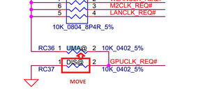

Place the schematic according to your motherboard.
Usually, the conversion operation can be done by removing the graphic power supply coil.
In some new models, there is no internal graphics processor and this is not possible.
I think it does not have an internal graphics processor.
The processor model is written on the chipset.
It may be written in its specifications whether it has internal graphics or not.
Check it out.
Only DIS is written in the schematic.
