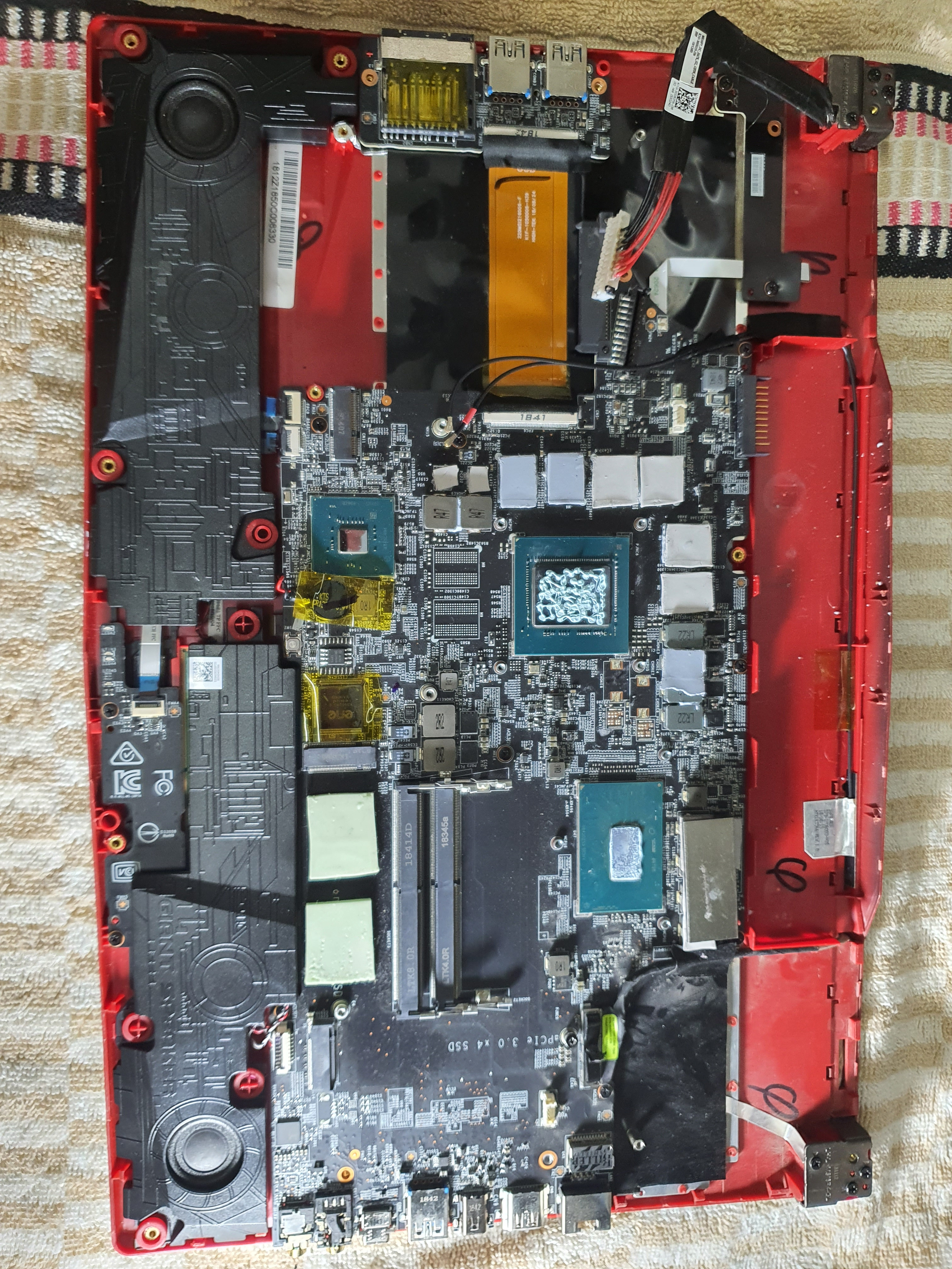

I am not sure but i send you some photos for that you seeboard model is ms-16p7 ?
Of course, the board model is ms-16p7check under all stickers and also under heat sink

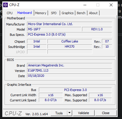

The BIOS work spectacular (it solve the freezes randoms while run Operating System or when I am in the bios). Now, I have another problem, the GPU no work, for example, when I run a video game, the game run very slow or not work (before of all this, it worked good), I saw the task manager and the use of GPU is 0∼1 percent... Conclution: the GPU isn't work correctly, I think that the problem could be solve if I flash bios of GPU.the bios is working OK
What do you think?
