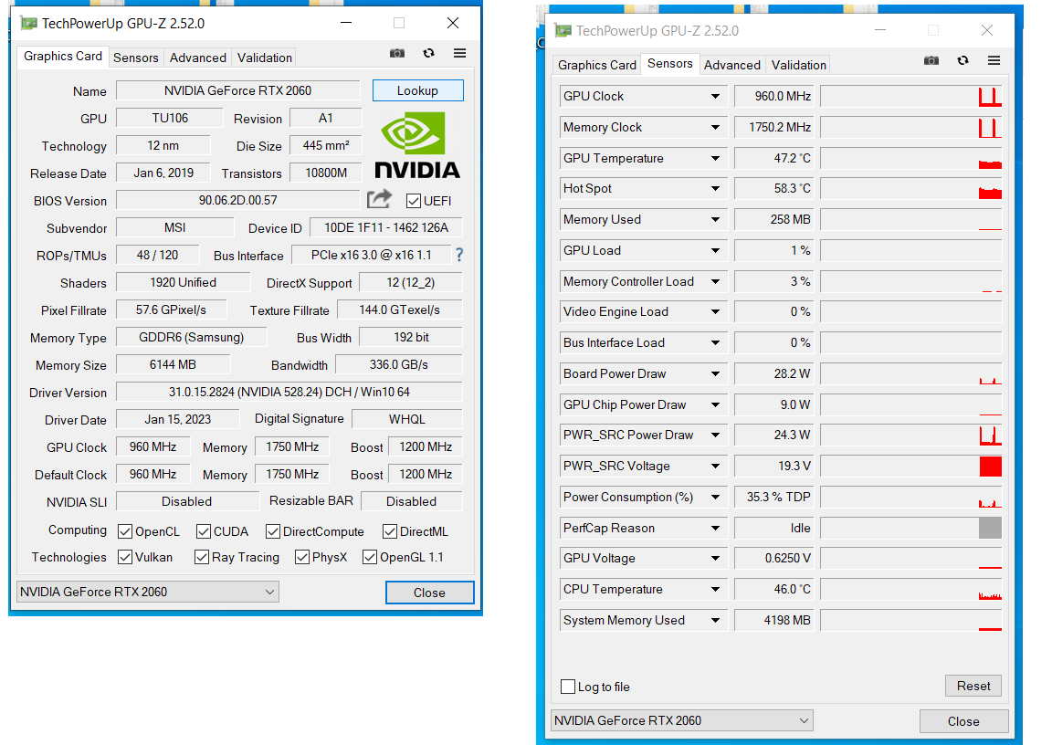

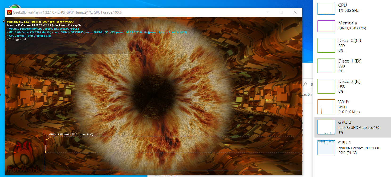

I saw the GPU Clock is slow, it is 300MHz but it should be 900MHz. I think the voltage is desconfigured
octavio
Do you need another Bios?
I thin not. The problem was resolved changing termal paste.
