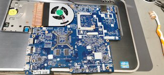

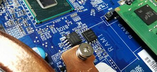

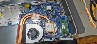

thats right. my laptop is w650sb, it writes it on the label underneath (not taken photo). please find attached the mobo photos and ec bin 2mb. no one else has opened the laptop before

Hello. you think there is something else you can see on this case?is there any other bios to try maybe?thank you
