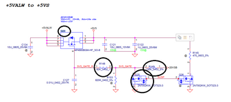

pin 4 has a problem.
It should be 20 volts that passes through the resistor which usually breaks down. There is a transistor and a resistor behind the hdd socket. Check them.

If you have tested the parts specified in the image and they are not defective, you should program SIO.
