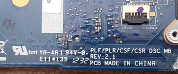

i have this model with motherboard PLF/PLR/CSF/CSR DSC MB Rev:2.1
When I press the button to start it shows me a black screen and the fan turns on.
I tried with a new bios, ram, cpu but it did not work.
With external monitor is not working
there is some idea of what might be wrong?
thank you

Thanks for the help. what method should I follow?
Have you chcked display connector,voltage and diode mode readings on pins?
Have u checked LPC_Frame? Diode mode readings?
Have u checked AD Line (0-3) for the display?
U need display before backlight. So focus on fixing display first.
