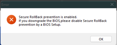

[2026/2/21 3:31:25] version 31.19
OS = Windows 10 64bit
Driver Loading....Done
System BIOS Version -> R0RET57P
Applying BIOS Version -> R0RET53W
Note : Applying BIOS is older than System BIOS.
AC adapter/Battery check....OK.
BIOS Flashing....
The number of retries of BIOS update = 1
The number of retries of BIOS update = 2
The number of retries of BIOS update = 3
Failed.
Error : An unexpected error has occurred.
Error code = -1073741819
