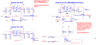

I am working with LA-4495P ACER 4736G upon my checking 19V, 3ALW, 5ALW is present however upon checking the RSMRST has 3.3V even the PLTRST after powered on at a couple of seconds only.
Also below are the components with value during my checking.
What else can I do with this?
I already attached the diagram for our common reference.
